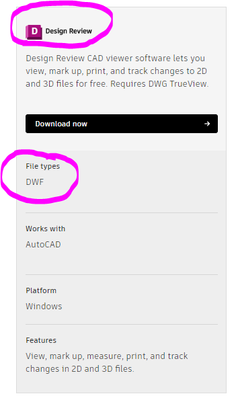

@sbutler502 wrote:
...I downloaded the current Design Review and it does not load rvt files.
ADR 2013 (and newer or older) has never EVER opened RVT files: the program only reads PDF and DWF files natively. They do try to find a matching year-version REVIT (or AutoCAD) program on the same PC to do a quick conversion for you, but I doubt you have that old a REVIT anymore. Sorry.
Look it up
Try the online Autodesk Viewer instead (it's online)
https://viewer.autodesk.com/
