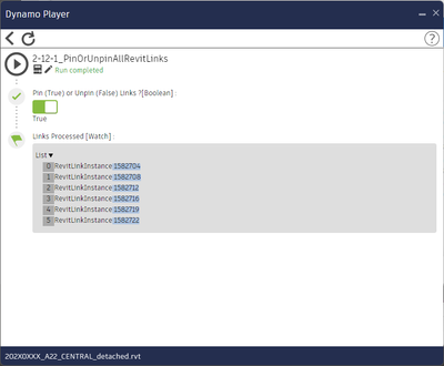

I just discovered a native node that will pin or unpin elements.  If you do not want to install Orchid, or just prefer native nodes when they exist, then this graph may be your cup of tea.  As a bonus, the Boolean node can be set to True to pin the elements or False to Unpin the elements.
It is Dynamo Player friendly - you can toggle the Boolean input and will see a list of processed links as output.
Created in Dynamo 2.12.1 for Revit 2022.1.3.
