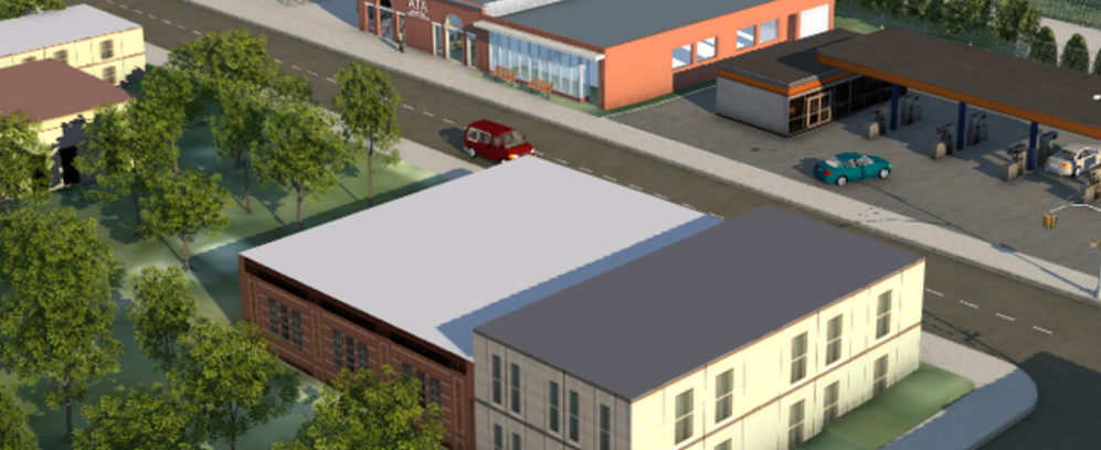

In the image shown below, there is a gas station on the corner of the intersection, vegetation throughout, and traffic signals at the intersections.
Proposal 2 - New Elements IncludedProposal 2 - New Elements Included
All these elements have been drawn in my Proposal 2, however, now I want some to appear in my Proposal 1. As you can see in the image below, Proposal 1 is rather barren.
Proposal 1 - New Elements to be AddedProposal 1 - New Elements to be Added
