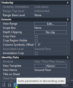

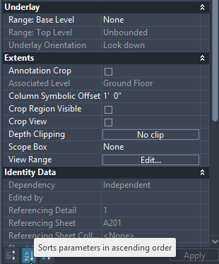

 Properties Palette Sort Function:
 In the Properties Palette, you can sort your list by default order, from A to Z or from Z to A.  It’s cool.
