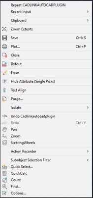

Out of the box, the right-click menu is functional to start drawing. However, to be efficient, users can tunnel into commonly used commands not easily accessible without jumping through hoops. Shown below is the default menu in AutoCAD.
The commands listed are functional for all AutoCAD variants. In my case, I am using AutoCAD electrical (ACADE) and prefer to stay in the "schematic" ribbon for my drawing session. There are, however, some basic commands and some "non-schematic" commands that I frequently use. Below is an example of my modified menu is shown below.
I have added file management and basic CAD functionalities that I commonly use in my daily routine. You will notice that the list uses more screen real-estate. This is something to keep in mind when deciding what to add. If you are using a laptop, screen real-estate can be scarce.

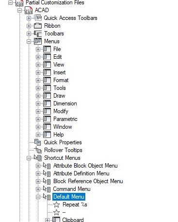

There will be a new window open up containing many features. This window, at first, can be very intimidating to the new AutoCAD user. Follow the noted directory path below to get where you want to be.
Expanding the selected list, follow the path shown below.
