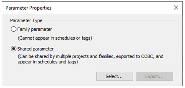

After the Create or New Parameter options are selected, the Parameter Properties window will open.
  • In the Parameter Type area, Select the Shared Parameter option and pick the Select… button. This will allow you to select Shared Parameter to load.

In the Parameter Properties window in the Parameter Type section, Select the Shared Parameter option
  • Then pick the Select… button to open the defined Shared Parameter file.
