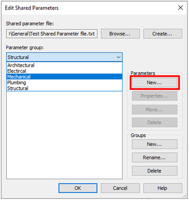

After creating the Shared Parameter file, Parameters and Groups can be added. I prefer to plan it out and create my groups first, at least the ones I anticipate needing. Groups help sort the parameters that will be created. More groups can always be added later, as needed.
In the Group area of the window (Bottom Right)
Parameters can then be created and added to specific groups.
In the Parameters part of the window (Middle Right)
