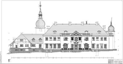

They studied the photographs provided by Anatoly Izotov and Oleg Shatailo, as well as very detailed drawings on which Izotov worked for more than two and a half years. In addition, there are publications, videos and other materials found in open sources. 
Such a preliminary study helped to assess the complexity of the geometry of the building, identify potential points for scanning and think over drone flight routes. We paid special attention to basements, tower domes and areas with partially damaged ceilings - they required increased caution during work. 

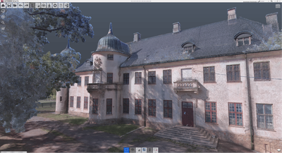

Data processing in Autodesk ReCap is currently underway. We have already worked out the cloud of dots of the Palace from the outside.
I log scans, clean point clouds, and check for matches between ground and air data. 
The goal of this stage is to obtain a single summary point cloud with high density and precision, covering both the exterior and interior of the palace. It is this result that will become the basis for the further creation of a BIM model in Revit, which will be discussed in the next part.
