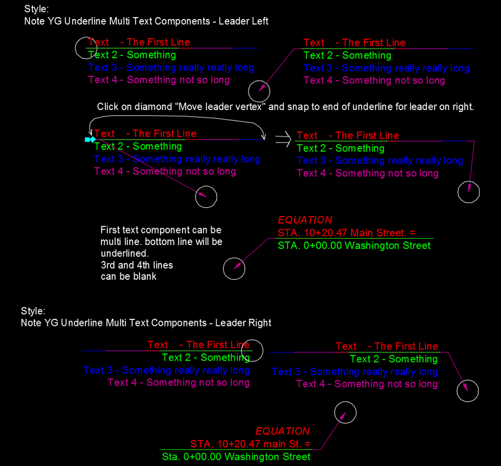

@ChrisRS This is a common scenario for us. Almost all of our styles are built to underline the first line of text. Many styles have 2, 3 or 4 separate text components in them (station, offset, elevation, text, etc.) and we don't always know which line will be the longest. Here is a basic example of when that causes a problem:
In these instances, the label is either exploded (with a small polyline added and grouped) or the plus sign is used to add a vertex in the leader to extend the label. Both of which are frustrating when trying to move the label.
We could build a style with the line referencing the Top Text and one style referencing the Bottom Text for scenarios like the Alley ##, however, because of the underlined first line, we have to have left and right styles for almost every label. SO.... that would me an having four different styles just for this station equation.
If you have any suggestions I'm all ears....

@DJGinAZ, I think this is what you want.
Link: Underline Label Multiline
There is a Right Leader version, but I prefer the Left leader version with the leader vertex snapped tot eh right end of the underline. This stays connected if you move the label, but needs to be reconnected if the label contents change causing the underline to change.
I used color and draw over so you can see the 4 underlines. You will want to use one color, probably "Bylayer"
Of Note:
Text height is 0.06, gay is 0.02, resulting in a line spacing of 0.10. You will need to adjust if you change text height.
Left Bottom of "Text" is anchored to feature.
Top left of "Text 2", "Text 3" and "Text 4" are all anchored to bottom left of "Text"
"Text 3" and "Text 4" have Y offset of -0.1 and -0.3 respectively.
"Line 1" start and end are bottom left and bottom right of "Text" (pretty obvious)
"Line 2" start and end are top left and top right of "Text 2" (also pretty obvious)
"Line 3" start is top left of "Text 2" and top right of "Text 3". End Y offset is 0.10
"Line 4" start is top left of "Text 2" and top right of "Text 4". End Y offset is 0.20

Interesting work around. I like it. For Text 2,3, and 4, are you anchoring them to the feature with a Y offset OR to the text above it?
I believe the only practical option is the "Leader Left" setup you created because our text is traditionally left justified. I'll explore it more using that solution and see if I run into any other problems.
Thanks Chris.

@DJGinAZ,
The Bottom Left of the first Line, "Text" is anchored to the feature.
Top Left of "Text 2", "Text 3" and "Text 4" are anchored to Bottom Left of "Text"
(In this case,I suppose you could anchor them to the feature since that is where the bottom left of Text is. In general though, I think it is more clear that the anchor is to "Text")
"Text 3" is Y offset -0.10, one line downward from "Text 2".
"Text 4" is Y offset -0.20, two lines downward from "Text 2"
