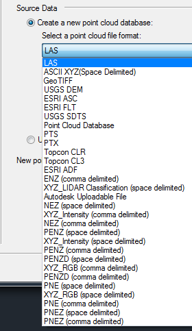

LiDAR data is freely available on the Internet, but good luck trying to get it into Civil 3D. The two most popular formats, from my observations, are LAZ and zLAS. LAZ is a compressed LAS, but that format is open-source, so Autodesk should include it. As things stand right now, you have to use LAStools to uncompress a LAZ. zLAS is an ESRI proprietary format. ESRI has a free "tool" for unlocking it to LAS.
Except for Tiff's, I've not run across ANY of these other supported file formats:

OK, but how are you going to work on data if you can't bring that data into C3D? I guess that's my point. And I just do not understand why ReCap changes a perfectly usable LAS format into something that can't be used anywhere else. ReCap is an interesting Viewer, but at some point you have to DO SOMETHING with data to make it useful.
And how about those "existing" decompression tools? I certainly didn't find out ANYTHING about them from the Knowledge Network. If you want people to use an Autodesk product to work on point clouds, then you should provide some links to things like LAStools. You could put it like this:
Autodesk can't afford to spend time and money to make common formats usable in our products. Instead, go get this FREE program off the Internet...
