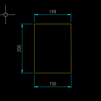

look what i have done here: For example if the kerb is 150mm wide offset the feature line 200mm higher and then 1mm to the side, the difference is so small its not easily visible

I recommend you make that small offset a larger distance. You may find c3d has triangulation issues with very small offsets. Using 0.05' (15 mm) or more usually works well..
