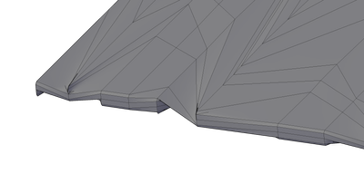

At first glance, it looks fine to me too,
but if you look closely, you can spot areas where the thread is twisted.
And here’s an example from the working file.
The situation there is even worse.

Hey,
I've looked into it, your chamfers are throwing it off. If you were to build it..consider this, just poped in my head, create a 90° rectangle, and your overhangin' bit with two chamfers (top and bottom) as a separate shape in the same PKT, tied in on the side. Also, if there's no specific need, you can ditch the side-mid points completly.

durasovartyom
My initial assembly looked like this.
I explored how to create a rectangular shape between two surfaces. But I didn’t want the 3D Solid to throw an error.
If you apply it to a complex surface, you’ll see that it also becomes distorted.

There are no errors on your part.
Solid extraction from surface links didn't work at all a couple of releases ago until Autodesk proudly announced that it's a feature now.
Their implementation sucks though and while you might get a somewhat satisfying solid for the most basic of situations, it's not reliable at all and produces the distorted results you are experiencing.
There's nothing you can do really - the only option I've found is to turn away from surface links altogether. One alternative approach is to calculate "intermediate points" between the outermost points and form the shape that way.

by my expiriance the twister in the solid based on the behavior that internaly the points with the same number in PKT are connected.
In the German Country Kit is a variable curb, where you can switch between curb with rounding and curb with chamfer. On the chemfer I have defined points of the straight line. The point numbers of starting and ending the chamfer have the numbers like from the rounding.
So I get a perfect solid from corridor.
