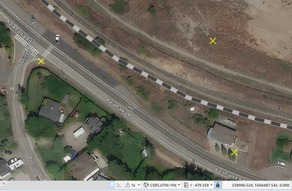

Why does the geolocation tab disappear when I try to use UTM with the NAD83 datum instead of the WGS84 datum?
We work in NAD83 epoch 2002 where I live, will using the WGS84 version affect anything?

Do you use GEOGRAPHICLOCATION or EDITDRAWINGSETTINGS to apply the coordinate system to the drawing? Depending on how you intend to use that setting, it may or may not be a problem - are you just using it to align an aerial?

See attached short video of the issue. When I already have the aerial turned on then switch to nad83 it loses the geolocation tab but also brings in imagery of some other location that I cannot turn off. Notice the shift in the WGS imagery.
sgleadleD3EMJ
Im using the coordinate system for the imagery but I also set a scale factor to be able to view and use my grid coordinates.

I get same as you in 2023, but 2022 works as expected.
In 2023 I also get "Warning: Cannot save projection code to the drawing." Which might mean a problem with Datum Transformation, NAD83 to CSRS.
You should definitely open a support ticket with Autodesk.

Figured it out. Looks like you'll need to add the Canada-wide NTV2_0.GSB file and also the British Columbia specific BC_93_05.GSB file to your "Geospatial Coordinate Systems 14.09" folder. I'm doing that right now and I'll let you know if it works.

I have those GSB files now, I just cant seem to find the folder you speak of.

Yup, that was it. I thought those GSB files would carry over from year to year, but I guess not. Edit your NAD83_TO_CSRS Geodetic Transformation in MAPCSLIBRARY. Add "NTV2.0.GSB" and "BC_93_05.GSB" to your Grid Data File Interpolation collection. Make sure the BC file is above the Canada-wide file.
The folder you're looking for is C:/Program Data/Autodesk/Geospatial Coordinate Systems 14.09. You'll see that the "Canada" folder only has a ReadMe, but not the GSB. Autodesk doesn't include it because those GSB files are proprietary.

Worked like a charm, than you very much.
The Bing imagery is still shifted a few meters, but is closer. Why is that?

Bing is never perfect. Neither is Google or ESRI imagery. And none of them match.
If you'd like to shift Bing, there's a method >>>Here<<<.
