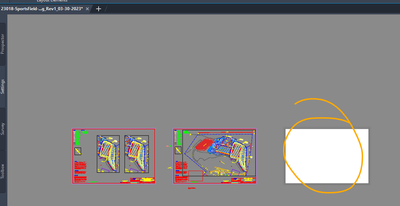

I need help deleting a viewport.  I created a polygonal viewport.  I did some edits inside the viewport turning off stuff in just that viewport.  When I went back into paperspace my viewport became a rectangle with no boundary.  And now I cannot delete it.  It has happened 2 times.  My layer "W-VIEWPORT" is on and unthawed.  I did NOT use VPCLIP so that solution did not help.  I have done a PURGE and AUDIT.  It has happened 2x in the drawing.

Hi @ChristopherVol, enter the _qselect command and then set the proper conditions for C3D to select it for you:
Think of a characteristic you already know of that viewport. It might be a color, layer, or whatever you can identify it with. Then hit OK, and you'll have the viewport selected.

Hi guys, as I mentioned in my post, by doing a quick select it is possible to select the viewport and erase it. I just downloaded the file and erased the viewport of the "Pre-Construction (24x36)" layout. (See the image, it is gone)
The selection criteria were these. (First image- before selection)
After selecting the viewports:
After this, it is just a matter of unselecting the viewports we don't want to erase and get rid of the ones we want.
If you don't want to delete the viewport but want to see its border again, double-click on it and hit this button (_.VPMAX)
The viewport will maximize. Then hit the button (_.VPMIN, the same button but with a different command) again and you'll have the borders visible as they were before this issue occurred. (see the image)
I hope this helps.
Best regards!

M_Obradovic
Hi  cvolosy ,
Can you try to do following
  • Double-click inside the viewport to make it active.
    Maximize the viewport by clicking the + sign in the top left corner.
    Change back to paper space and you can now see and select the viewport.
Hope this will help.

I did that. It became visible. But when I try to delete it, it just deletes the boundary again. The viewport stays.
Message 15 of 18
ChristopherVol
This did NOT work. I deletes the boundaries I was able to delete before. But I have two viewports that have NO borders that I cannot delete.
Message 16 of 18
M_Obradovic
Hi  cvolosy
Please see attached video. You have 5 viewport one over others.
Message 17 of 18
ChristopherVol
AH! How did that happen? I made ONE viewport each.
Message 18 of 18
M_Obradovic
Sometimes happen weird things. BTW I hope this method can help in order to solve issue.
