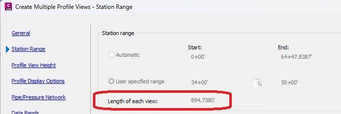

I set up a template for use with plan production tools to create view frames and sheets. When I maximize the width of my viewports to fit inside our border, the resulting sheet crops the profile view on each side such that the elevation columns on each side don't display.

In my research and testing, I found that there is a user specified range option when creating sheets but it is greyed out.
I'm assuming because the length of each view is coming from the length of the viewport in the template? There is also a User specified Profile View Height that is greyed out, but might be helpful when creating sheets.
