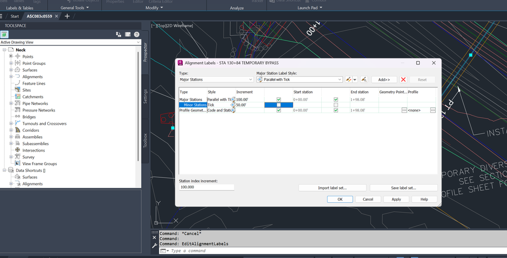

I can't seem to display the tick marks denoting minor stations, i.e., x+50 etc., on an alignment.
I select the alignment and then 'edit alignment labels' but I'm unable to check the box to display the minor station labels (see screen shot).
I'm a modest user at best.  Can someone help me out with this?Screenshot 2025-08-14 131701.png

Hi @Keta_Engineering
Can you share your file to take a look?
Regards
RobertEVs
That is not a display checkbox. It is for when you do not want to label the entire length with minors you can change the start and end stations which is moot because you cant change the minor stations regardless like you can with the majors.
My guess is you have a layer issue check your minor style and see what layer it falls on.

My apologies to all.  Th tick mark was hidden under a corridor sample line 🙄.  I swear I looked under these before I posted this thread.
