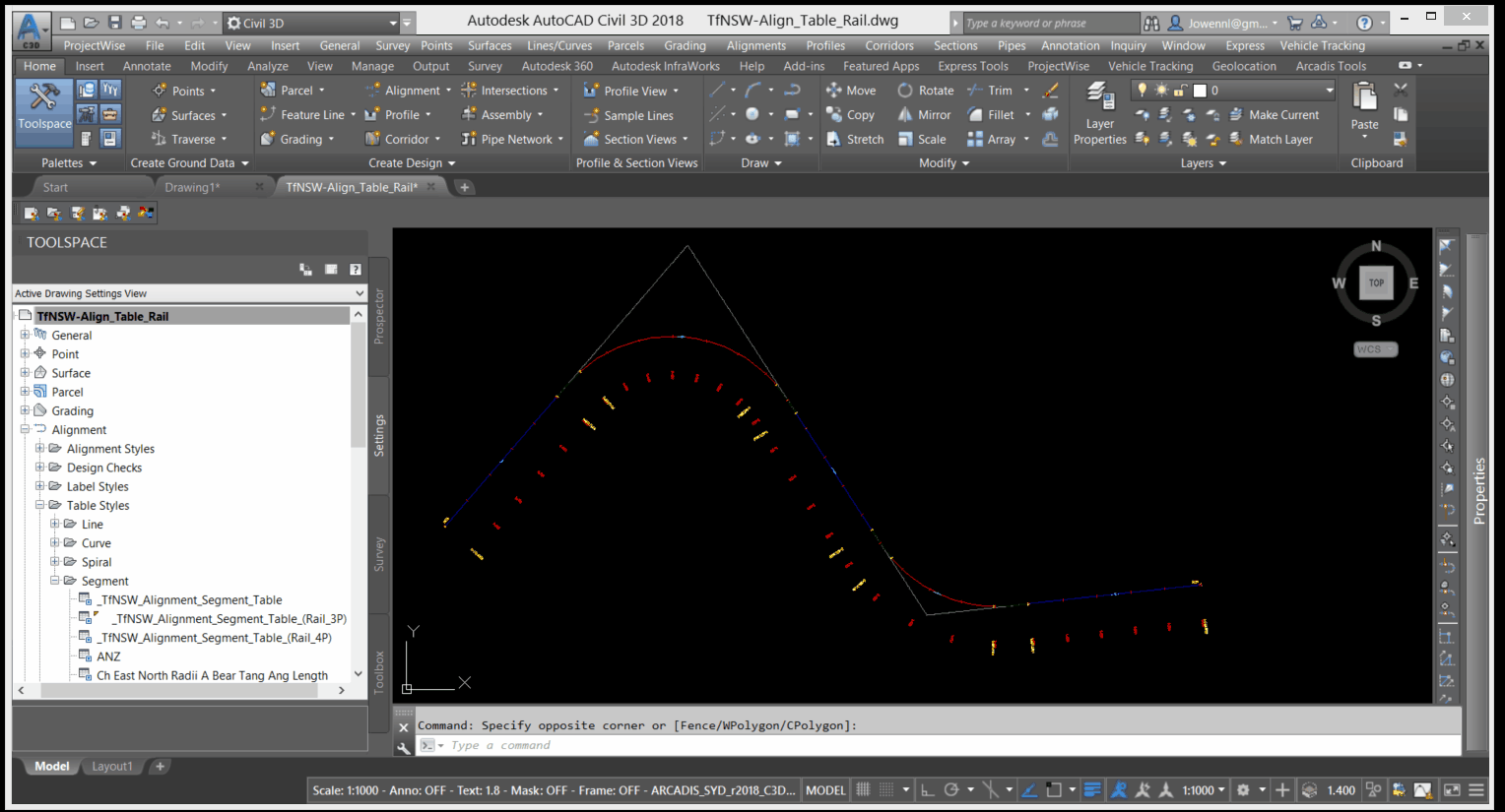

I was wondering how you managed to generate the table displayed at the beginning of your .gif animation?
I have been trying to do something similar, but I get a message saying no "tags" selected. I've looked around and have not really got a clear idea of how to create tags in Civil 3D for alignments, how to view them, or link them to tables.

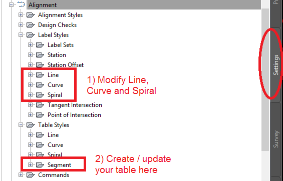

I did make that alignment table style customized to what I need. If you want to create alignment table. You can create them inside Civil 3D.
Steps:
  • In the Settings tab > Alignment > Label Style > (You need to update Line, Curve and Spiral then setup option as Tag Mode or Labels and Tag Modes)
  • In the Settings tab > Alignment > Table Style > Segment (Then modify or make your table style here)
  • In drawing model space select alignment then in ribbon click Add Labels > click Add Multiple Segment
  • In drawing model space select alignment then in ribbon click Add Tables > click Add Segments
 Toolspace - SettingsToolspace - SettingsSample - For CurveSample - For Curve
For demo please see attached animated gif (AlignmentSetoutTable.gif)
You need to play around with the settings to suit what you need. Tag will give you L1, C1 and S1 as numbering and in my sample I just don't like the number and force them to be L, C and S. and make them Tag Mode only so it won't display in my alignment as label and this is just my preference.
