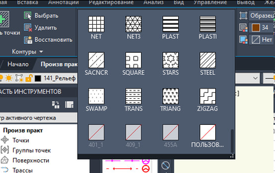

When working with various files, I use custom hatching. Previously, when copying hatching, it copied the properties and the image, now only the properties are copied, and the user image is visible in the image window as a square crossed out with a red line. Please help me, please.

The .pat file is missing, I'm guessing you don't have that? Are these hatches you created?
If you've already tried searching for the .pat files then you could try the below:
Recreate the hatches by expoding them and using SUPERHATCH to recreate.
If you have the time / enthusiasm you could recreate the .pat files in notepad.
Other option is replace the hatches with standard ones.
As a last resort you can keep the patterns as they are, they should display as long as you don't change any properties. You can use MA to propagate them as required..

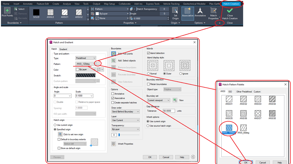

ChicagoLooper
@Fanbizer
That dropdown won't display an icon of your custom hatch.
To see a thumbnail of your hatch pattern, start your hatch to get the Contextual Ribbon, then go here:
