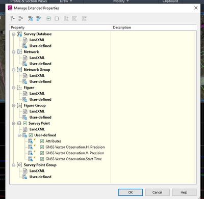

I am trying to import tree points, along with a ton of other survey data, through our survey database. I have set up user defined properties within the survey database itself. I have set up the user defined properties, identical to the SDB ones, because the SDB ones were not available in the point file format settings. And I have set up a point file format to bring it all in properly. All of this works awesome, and the UDPs come in properly, when I import through a CSV. However, when I bring the data in through the SDB, none of the UDPs populate the way they are supposed to. I am using the same CSV for both. I am sure that I am missing something very simple, but I have not been able to figure out what I am missing. Any help would be greatly appreciated.

I am having the same issue. I cannot get the points to keep the UDP in the drawing once inserted. Is this a bug?
I can import the points with the attributes but then I am not using the functionality of the Survey database.
