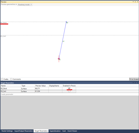

I want to have two slopes depending what surface it is Rock or Soil.
What is the "VB Expression"?
SurfaceTarget.isValid=("Rock",True)
Target Surface=Rock =>Slope=500%
Target Surface=Soil =>Slope=30%

Hi @Anonymous, in addition to the very good contribution of @jae.kwon. I want to attach here an option to solve that.
What happens inside the subassembly is the following:
1. I defined a variable by evaluating which surface is being targeted by the user. This can be achieved by
IF(EG_Rock.IsValid, "Rock",
IF(EG_Soil.IsValid, "Soil", "Default"))
2. Once it is defined which surface we have to target. A switch will help us select the right code path. There are three options: Rock, Soil, and default.
3. If it is set to default, nothing is going to happen, but if the variable evaluates that one of your surfaces is targeted (Soil or Rock). Then, a point and a link will be drawn according to the slopes you gave. The decision I put in the middle is just to know if the condition is "fill" or "cut," since you didn't say if you needed the subassembly for "cut" or "fill," this works with the same slope for both options. If you don't need "fill," just get rid of the decision and the fill branch of the code.
Look what happens when I enable one surface or another in the target parameters.
Soil Surface targetedSoil Surface targetedRock Surface targetedRock Surface targeted
I have attached the PKT file as well so you can check what I did. I think it is what you wanted. But let us know what you think. I hope this helps. Best regards
