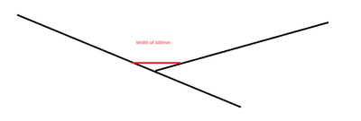

I'm trying to figure out a way to create a fixed width ditch at the intersection of two different slopes.
I already tried to pull out the intersection point of the two slopes and create an offset of both to have the 300mm plateau but one side never fits in Z since it's not symetrical

Alright,
After giving it some rest, an idea poped and it works :
Offset the plateau at the top slope and make an auxiliary slope so that it targets the oposite slope :
