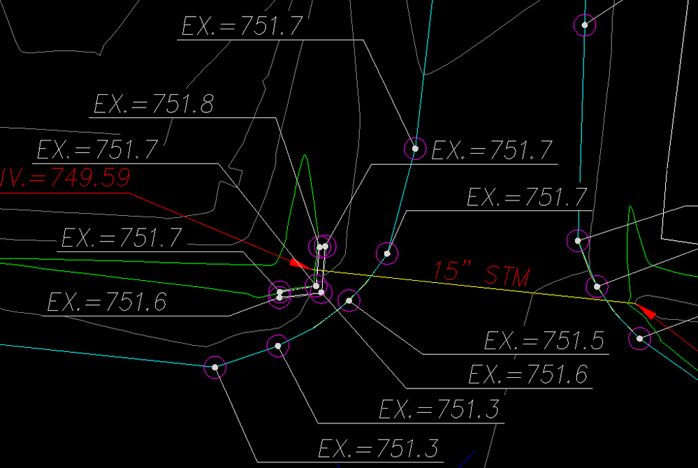

I use a style to display the EX. points of a civil 3d surface. However, I can't turn of the circle magenta markers of the points. I know there must be a display panel to make control of the display style but I can't find. Can anyone help? thanks a lot!!

When you are going to place the labels, go to Add Surface Labels instead of straight to Spot Elevation.
That brings up a dialog. Set the Label Type to Spot Elevation, pick your desired label style, and then set Marker Style to None.

Thanks Tim,
I did it by adding surface label as you said. I have figured out the problem: when you adding surface label, there is a dropdown menu for marker style, which I should select none. However, if I have already added the surface label, I could only change the label style rather than marker style. This may be a imperfect of civil 3d program I guess. Thank you!

Just to add to Tim's post, if you have the labels in the file, select one, right-click and choose select similar. Go to the properties dialog and you can globally reassign the marker.
