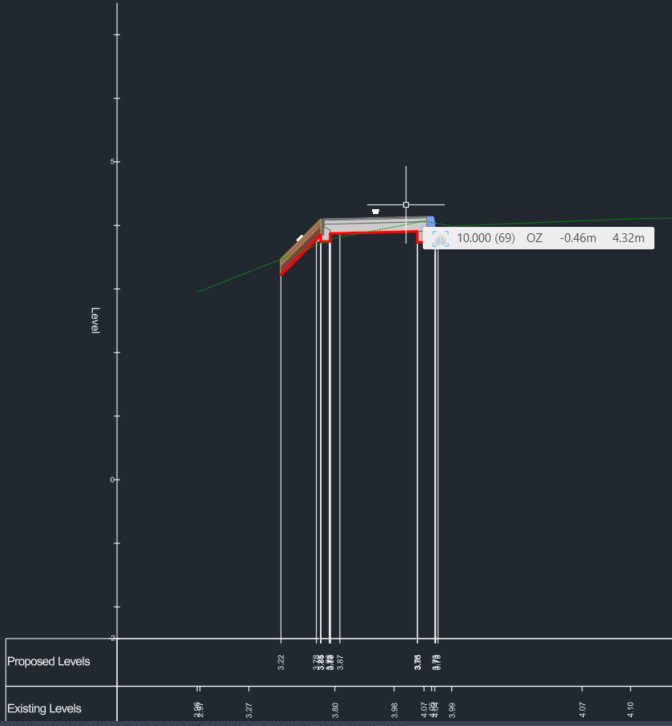

I'm running off some sections and seem to be struggling to do some simple tasks. I want my sections to be at a particular elevation range, between 2.5m to 5m. The default elevation range is -2.5m to 7.5m which doesn't seem to tie in with any data on the model.
Below is an example of the section with default elevation.
Selecting each individual section and view properties I can amend the elevation range as below.
 But i can't then match the properties of this section to the remainder of the sections and if I look at View Group Properties, it doesn't give me the ability to set a user specified elevation range.
Can any one help me find a quicker way to update these section so that they all have the correct elevation range?
