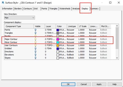

Hi @junkins
Have you applied a surface style and turn on Major and Minor Contours? If you still have no contour display try turning off LEVELOFDETAILOFF command.
Please review this AKN article on Surface contours are not displayed in Autodesk Civil 3D that provides you with a solution when Civil 3D has created and a contour style assigned, but there are no contours visible.
Please select the ‘Accept as Solution’ button if my post solves your issue or answers your question so, other Community members may benefit.
Thank you for doing so, and I'm here to help.
Wendell Bush
Civil Infrastructure Technical Support Specialist

Hi @junkins
It's DISPLAY TAB on the Surface Properties.
Wendell Bush
