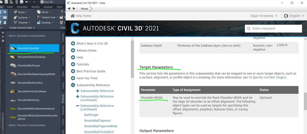

Hi @Anonymous, in the subassembly help of the shoulder you are using, check if there are any target parameters associated with it. If you have a parameter to override the default width, target (Horizontal target) the polylines you show on the image to get the geometry you need with the desirable transition.
I hope this helps. My regards!
