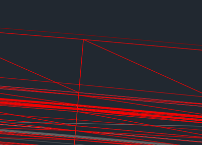

Hey,
Im trying to arrange my section view but there is always gaps between bands and title. How can I remove it? I want onlysection to be visible, without space gaps.
I want to be no more than 1cm offset from band and top axis. Thanks.

Check your style, display options. Those line look like they are the Axis, you can turn them off, or the Drafting Buffer, you can turn that off also but as is doesn't plot there is no real need.
Otherwise post a drawing so we can look and see which component type you're referring to.

Ive tried but they are still looking messy... Here on this screenshot I think its visible.
I want profile to be in the middle always.
And do you have idea why proffile is missaligned sometimes?:
This missalignment is breaking bands also. Assembly is custom created.
In plan its also kind of miss aligned:
apdim
Im trying to find why this is happening...
Its happening almost everywhere-curve, tangent, cut, fill
It looks like it cant snap right to surface but I cant find way to fix it.
In plan view I can see that wrong surface only on outer side of curve, corridor surface do not snap to corridor boundary. On innerside its okay.
You can see boundary(yellow line on the top)...
apdim
Ideas?
