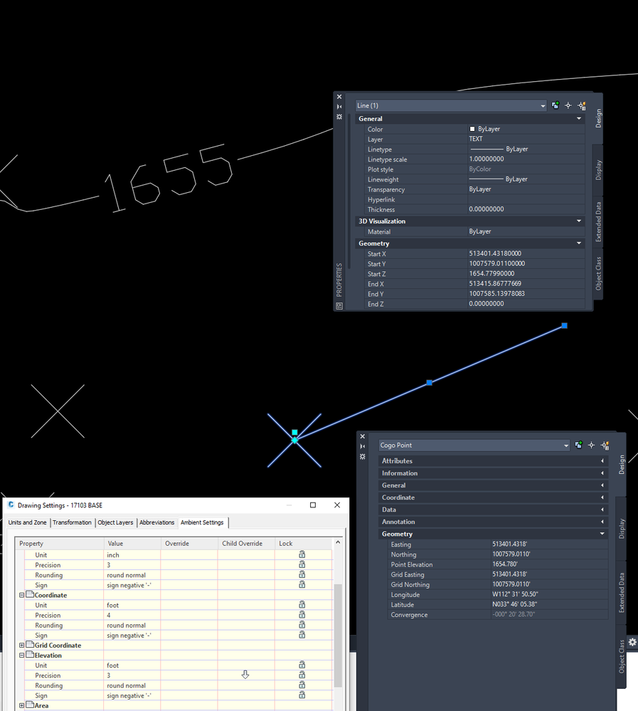

What is the actual elevation of your survey point?
This is from a survey I received for a surveyor. (I converted LDT points to C3D Cogo points)
          A Line has been created, snapping one end to one particular point.
The elevation of that particular point is 1654.780 (See lower right)
The elevation display precision is controlled by the
          Drawing Settings Elevation Precision setting, in this case: 3. (see lower left)
The elevation of  line endpoint is 1654.77990000. Display of this elevation is controlled by "Units"
Rounding is based on the full precision of the point elevation, or surface elevation.
