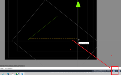

Joe-Bouza
Jeff Mischler showed me this. takes about 5 seconds
 @Jerry_Barnes , @BrianHailey , @AllenJessup , @rgrainer , @doni49
SHIF>>@ PICK END OR NEAR ON LINE
 F8 AND YOUR VIEW IS ROTATED TO THE OBJECT.
The just gip the corners ti the paper
Joe Bouza
Message 11 of 16
doni49
