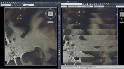

HELLO,
I'M INSERTING A GEO REFERENCED TIFF INTO MY DWG.
ON THE LEFT IS AUTOCAD C3D 2020 AND ON THE RIGHT IS 2022.
ALL MY SOFTWARE IS UP TO DATE AND THE 2022 HAS ALWAYS DONE IT.
THE WORK AROUND WAS TO USE 2020.
IS THERE A SETTING I AM MISSING?
I'VE TRIED THE INSERT QUALITY.
CHANGED MY GRAPHICS SETTING AND THEY BOTH MATCH.
WHAT ELSE AM I MISSING.
THANKS FOR YOUR HELP!

Pointdump
Eric,
Update AutoCAD. (Not Civil 3D) That'll fix it.
Dave

Pointdump
Eric,
Oops, I mis-remembered. Read >>>Here<<<.

OLBALOO
AWESOME, I'LL HAVE THAT DONE.
I.T. WON'T LET ME DO IT, I HAVE TO PUT IN A TICKET...UGH!
OLBALOO
I DID LOOK AND I DO HAVE THE 2022.1.1 VERSIONS FOR AUTOCAD.
THANKS AGAIN!
