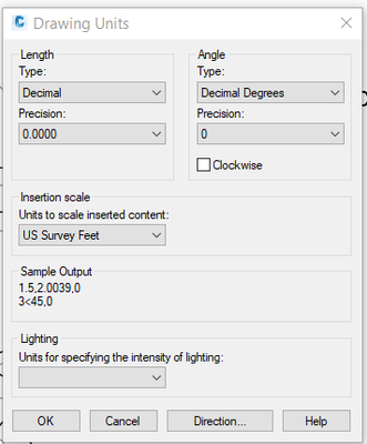

Check the units used for each, is one using International Feet and the other US Survey Foot?
Message 3 of 19
bhaeffner
As near as I can tell, both are in US (Survey) Feet.
Regardless, the same units and CRS were used in the .TIF and the .SHP in QGIS. I can't see why/how they would be projected differently in Civil3D, except that the contours from the shape file are at elevation 0 instead of 7-hundred something.
