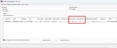

In my profile views I can label start and end station of my PV. Looking at my (image 1), in my profile view style I get a station label of 0+49. If I pull my PV to an even 0+60 I can still see my PV bottom axis major label of 0+60. It stays; however, my Band style does no longer displays. (image 2). I do not use both station labels this is just to show my problem. I use Band style stationing only.
Can a band style stationing be shown for the begin station of PV lie the PV style does? (second image)

After some testing I see if I set my PV to 0+59.99 my PV will keep my band style label in there at 0+60.
MMcCall402
If you go the the Bands tab of the profile view properties there are check boxes for labelling the start and end stations for each band that's been added to the view.

And there it is.
