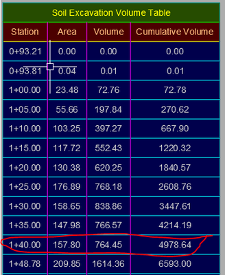

Thanks for the response. Unfortunately, the hatch and the associated cross sectional area are both wrong.
Here is the volume table for the first case:
