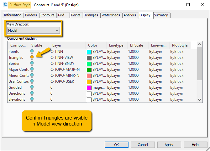

You have to edit the surface style. Go to the Display tab and make sure that the layer state is set to Model (3D views) and set the layer display to however you want.

Hi @pics.munmun
Please confirm if the Triangles are visible in the Surface Style.

even after making triangle visible, i face the same issue. Initially when i click on object viewer, the surface is visible. As soon as i try to pan or rotate the surface vanishes and only points are visible.

OK, you have three different surfaces using three different styles.
_No Display has nothing at all turned on in Model view display.
Border Only_Existing has only Triangles turned on in Model view display.
Border Only has only Points turned on in Model view display.
So my question is - Are you editing the right surface style to set the display state how you want it?

Hi @pics.munmun
I recorded a short screencast to demonstrate the settings necessary in the Surface Style. To view the Surface in object viewer, we must ensure the Surface style applied has at least one component visible in the Plan view direction in addition to the Triangles component is visible in the Model view direction.
