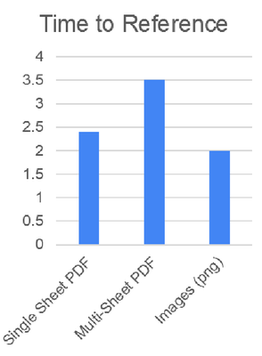

brian.strandberg
Generally I find images to be faster to use than PDF's, and single sheet pdfs are faster to reference than multi sheet pdfs.
In bluebeam, you can export a PDF sheet as an image very easily.
I tested this in Civil 3d 2024.  I spent the time writing a script for testing this because there was an argument to be won, I won

NateSarles
     "I spent the time writing a script for testing this because there was an argument to be won, I won"
@brian.strandberg, I can respect that statement! hahaha
Now, can you quickly modify that test to include TIFF to compare to PNG?

brian.strandberg
I could do that - I used .png because .png will be smaller than .tiff for the same number of pixels in the image.  If you need extremely high quality images (usually not the case for details being referenced), .tiff is a better choice.
