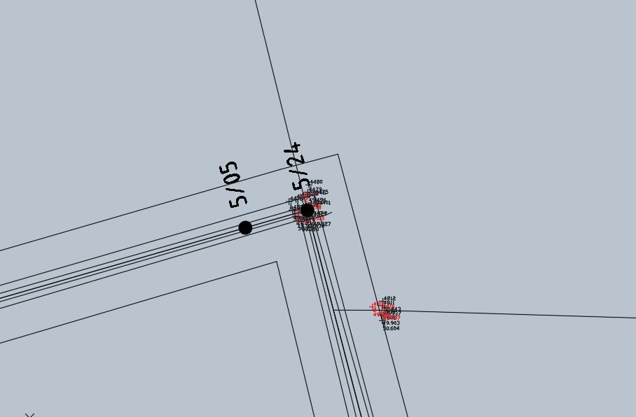

This is quite a problem for me, I hope that you can help me.
I tried to find sulution in other topics but my situation differs from those.
The situation is that alignment offset doesn't appear on the right side of alignment. For your information, I don't use from start to end alignment.
The problem might be the radius of the alignment, as i conclude from other topics but i havent solved the issue.
I appriciate your help in advance.

Most likely you have a link or radio to small to accommodate the offset.
Do an offset for the beginning station for a short distance and do not lock the ends. Now grip it and stretch along until it goes no further; that's your trouble spot. At least the first one

Yes, I attached it.
atisklavins
Okay, that is a way to find troubuled spot but what exactly do I have to do to solve the issue.
How can I make aligment radio bigger? Sorry if this is a silly question, I am new to civil 3d.
Joe-Bouza
Its geometry. If you are offsetting a 6 foot radii 10 feet the computer cant do it. to fix it you inside radii must be greater than you offset value
