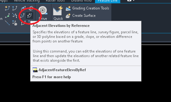

Joe-Bouza
"elevation by adjacent grade does this"

dorvoscristian20
Thank you for your answer, but I think that this tool is fixing half of my problem, will fix the slope/grading between the 2 feature lines by chancing the levels of the targeted feature line but will not give me the 3% slope on the targeted feature line, because for this the tool needs to change the position of it not only the level.
I think that the answer for my question can be find somewhere in the grading tool, but I just don't find out where and how to ask for it 😞
