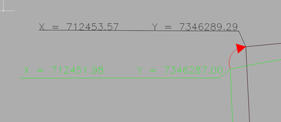

After finish all my project, i recieved a notification the cordinates of my project is wrong. I need to move a little bit all my drawing, and I don't know what to do that, cause I have some objects like surface, corridor and pipe network into my drawing.

It's an arbitrary coordinate.
Just wanna all my drawing point the green coordinate to black coordinate.

That's a tough one! For the Surface, you can move the underlying data with MOVE 1.59,2.29,0. The Surface will then move.
But I'm not sure about Alignments, Corridors and Pipe Networks.
So what happened? Why does your drawing need to move?
I think the Coordinate Transformation Tool is a separate installation, so look for it in your account page.
One possible way is to create a custom Affine Projection, using that shift. Then you can use the Coordinate Transformation Tool.
Dave

I think the best way to do this is probably to create a new file then Xref the original into this.
Reposition the Xref and bind the drawing.
I've used this for transferring corrupt drawings or reposition many of times. Using the Xref function allows transformation of coordinate systems.
When exploded, you should have the drawing as it was previously but in the new location.
Alignments or profiles with some entities (best fit etc) may need to be revised.
Surfaces will include a transform unit, you can erase this as the originating geometry will be in the new position.
You may need to go back through and check the objects are correct, rebuild coridors etc. but I don't recall having a lot of probolems with this method.

I created an Affine Coordinate System reflecting the shift of 1.59,2.29. I tried twice to transform your drawing to the newly created Affine Coordinate System. "Unhandled Exception" both times. I suspect that the Coordinate Transformation Tool will NOT transform to a custom coordinate system.
Looks like Mike's method is probably your best way forward.

It isn't working too... surface (triangulation) isn't match with the corridor.
Seems it doesn't have any solution. 😢😭
Fabricio
Message 17 of 22
MikeEvansUK
Fabricio this is because when you move a surface C3d adds a transform edit to the surface properties.
as the geometry designing the surface is moved you’ll see a double shift in the surface, you just need to erase this transform edit from the surface and rebuild then all should be fine.
