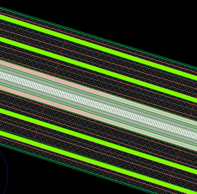

I am a beginner trying to design a railway in Civil 3D. i have tried to change the code set style etc. but as you can see from the image below, my corridor wouldn't show the proper bench and daylight/cut and fill.
Is there any solution that can help guide me through this?
The hatch should fully cover the daylight side, but as you can see it is not properly hatched
There is also an error where the bench is not connected, as you can see below

For some reasons, if i add code style to link of Daylight and Slope, it show proper hatch on the slope side of cut/fill. I still confused what I can do to solve this

Hi @ahmad_122210045  , I saw your corridor already have Material Area Fill style in your code set.
for example at Link code "Bench" and "Daylight" its already have set Material Area fill style
that @Jeew-m  mention your corridor are properly display.

Thank you @Jeew-m and @teerawat.pSCHYQ  for the reply. When it's come to the bench and daylight material, it is true that I have given a code for it because it's just the one materials that shown properly if I give a code.
But what I actually refers and wanted is the daylight cut and daylight fill Materials, as they're not clearly shown. When I activated the daylight fill and daylight cut material and deactivated the daylight base material, it's missing on the corridor. In my mind, I hope it clearly show between places that is fill and cut

teerawat.pSCHYQ
Hi @ahmad_122210045
if you add condition and create subassembly separately for cut and fill like this
then your subassembly composer maybe like this for cut with berm, See I have add link code name is "cut" this is for cut , another subassembly just given name for link code to "fill" or something
after that you need to import code into your code set style and then I think you can setup your code set style what you want.  something like this
see below you should get like this.

That is really helpful ! @teerawat.pSCHYQ Didnt know it can be applied like that. Thankyou so much
