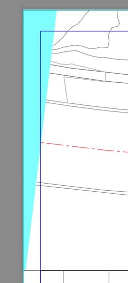

Update: I have a match line created and I want to cut off part of the plan view without a hatch fill like shown in the picture. I just want a straight angled solid line. I tried using the match line mask pattern line, but I still get this hatched area.  hatch fill.JPG
