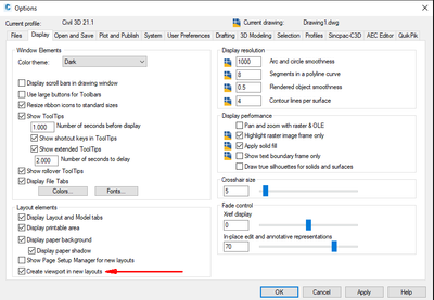

2. I click on the Layout tab and the subdivision shows up (that in itself I don’t understand) that I have done nothing to create
That's controlled by a setting in Options. If that's checked. When you create a layout there will be Viewport created. Also there will be Viewports in the default layouts.
Thank you.
