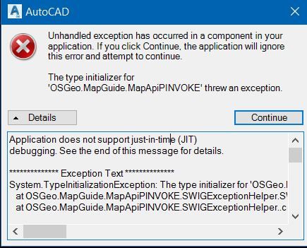

I tried typing in one of the commands that is normally included in the "Layout Tools" panel (-MAPINSERTPLE), and received the following error:
The full text is attached.   Any ideas?  Is there a way I could copy any corrupted files from my coworkers computer to replace them on mine to get this to work.

Found this in the error log:
System.DllNotFoundException: Unable to load DLL 'AcMapApiStubs': A dynamic link library (DLL) initialization routine failed. (Exception from HRESULT: 0x8007045A)
So it looks like you're having issues with a DLL. Kind of difficult to figure out why exactly but reinstalling may help

That's sort of what I'm trying to avoid.  I've already performed (literally) 6 complete clean uninstall/reinstalls.  I've also tried repairing the installation, but keep ending up with the same issue (or new ones).
