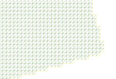

Here is what I got from the ASC file you shared.
 I could not see the contours for some reason until I exploded the surface. After that I could see what was going on as shown below.
The reason for jaggedness I believe is just due to how the data exists. It is a raster data and it is triangulating to triangles that are about 1 foot.
The reason it is so jagged is because there is that much detail in the data.

Also the data is on a GRID not a TIN this also makes a difference.

I dont think anything is going to help the jaggedness of those contours since it looks like the data was crated in rows and columns. Your triangles are where data was sampled from. This triangles are going to make perfect triangulations when you generate a surface. This is what really accurate raster data looks like up close.
