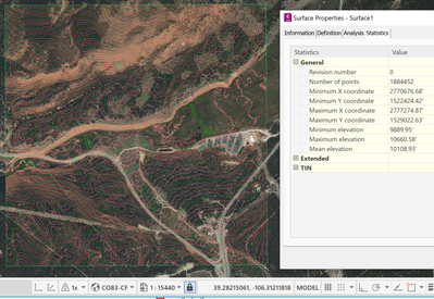

I have downloaded a geotiff to use for creating a surface (source: https://coloradohazardmapping.com/lidarDownload ) which is in the dropbox link. I then reprojected that tile using QGIS into NAD83 Colorado state planes - central zone - us ft (attached). I then imported that geotiff into my drawing (also attached)) that is set in feet and in the same coordinate system, It dropped in right where it should but was showing elevations just above 3,000', when they should be just above 10,000' (so the conversion of meters to feet I assume).
I tried to use the raster calculator in QGIS to convert to feet but that appears to multiply everything by that number and not just the elevation info. Also tried to create a blank surface then add the DEM as well as using the 'create surface from DEM' option.

ChicagoLooper
@ericL4ECC
<<...I then reprojected that tile using QGIS into NAD83 Colorado state planes - central zone...>>
So you re-projected from ? ? ? ? ? to Colorado State Plane, NAD83, Central Zone, Feet. Your data, prior to reprojection, had a Native Projection, correct? What was that native projection? Was the original native projection UTM84-13N, WGS84 datum, Zone 13N, meters, or EPSG 32613? If it was, then KEEP that projection native.
For example, assume the native CS is UTM84, WGS84, Zone 13N, meters. Instead of re-projecting in QGIS to CO83-CF, don't let QGIS reproject. Instead, keep the native and let Civil3D perform the re-projection for you. When it reprojects, C3D will TRANSFORM from UTM coordinates to State Plane coordinates....and that means it'll accurately land in modelspace.
As it is now, your North Ridge - tile.tif doesn't have 'elevation units' and appears to be defaulting to elevation of meters.
Image-1Image-1
Assuming the native projection of your data is UTM84-13N, WGS84 datum, meters, Civil3D's Add DEM window would look like this:
Image-2Image-2
Since 'feet' is indicated under elevation units in Image-2, you'll have the correct elevation units (feet, not meters) when you build your surface and STILL have geospatial accuracy in the X and Y coordinates.
Chicagolooper

ericL4ECC
Thank you so much chicagolooper, that worked perfectly. Your explanation makes perfect sense as well. Really appreciate your time and assistance!
