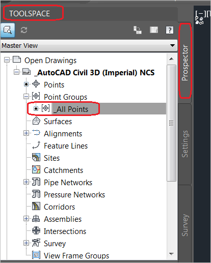

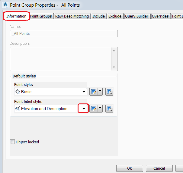

In toolspace, in point groups, right click on your point group, if you don’ t have point groups, right click ALL POINTS, select Properties. Un next dialog box change the point label style by using the dropdown.

Change or edit your point label style to only display elevations and descriptions.

No, you don't have to explode the point, that wouldn't be right, too violent, too aggressive. Use finesse instead. Here's an elegant way that's less ......annoying......, here's the how-to:
1-Toolspace>Prospector tab>All points (or your point group).>Right click>Properties.1-Toolspace>Prospector tab>All points (or your point group).>Right click>Properties.2-Information tab>Point label style dropdown>then change the 'Style' Then OK.2-Information tab>Point label style dropdown>then change the 'Style' Then OK.
