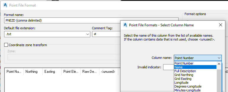

C3D only allows numeric for point numbers. You can use alpha-numeric point names and have them function as numbers for labeling, display, etc. In the point file format change point number to point name, when the points are imported it will use the names and assign sequential point numbers that can effectively be ignored.
Message 4 of 8
You can import and modify the input format. Where you select PNEZD format click modify and change point number to name.
Points will import and be allocated point numbers but the name will be the actual name of your point.

I don't see that option.  Can you explain again where that is, or send a screenshot?

Jeff_M
Double-click the Point Number column, select the Name property, OK
