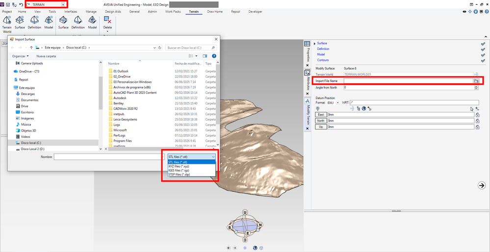

To import CIVIL 3D files into AVEVA E3D, you must use the AVEVA E3D TERRAIN module with files in the following formats: *.stl, *.XYZ, *.IGES, or *.STEP.
For optimal performance, we recommend using the STL or XYZ format.
You can obtain these formats from Civil 3D by exporting the surface to XYZ (CSV) or by converting the surface to a solid (using the _AeccExportSurfaceToSolid command) and then exporting the surface solid to STL (using the _STLOUT command or EXPORTARST in Spanish).
