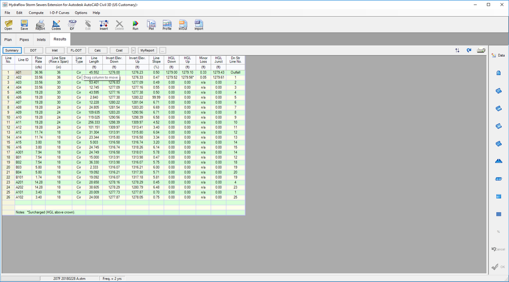

Good morning,
I am having trouble with Hydraflow Storm Sewers.  The HGL starts off at the crown of the outfall as I directed it to but falls to what I am assuming is 0 almost immediately.  I have QCed the input info and it seems to be connecting everywhere just fine.  I have also exported from this .dwg file before and didn't have any problems.  I just replicated that file set up.  I have attached some pics to help explain my problem.
Thanks in advance.

I found the problem. The "Use interactive feature" button was checked.  Once I unchecked it everything worked great.
