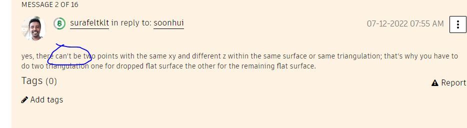

yes, there can't be two points with the same xy and different z within the same surface or same triangulation; that's why you have to do two triangulation one for dropped flat surface the other for the remaining flat surface.

you must have get me wrong sir; I did not say that you can have a surface containing the same xy and different z sir if u have read my first comment i say use two surfaces one for dropped part the other for the remaining flat part then paste then to create one single surface that's to avoid this issue.f1.JPGf2.JPG
