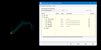

After so many trial and error i was able to create a sub-assembly using polylines, and manage to put offsets and elevations in my structure (1st photo). However i missed checking my diagonal height which should be around 2.5m (there it shows 3.7m). Now i want to fix it by creating another drawing and applying the code set style from this drawing, but then i cant copy the codes and its giving me macro error ( idk if this is the cause why i cant copy those codes though). Can you help me?
These are the codes i want to copy:
Here the codes failed to import
