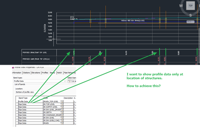

I have a pipe network. I want to show profile data at location of structure only.

In the band?  It appears you have that done.  Ultimately - the Pipe Network Band Style contains both structure and pipes elements in the band style.  If you do not want pipes - turn those labels off or remove the label components off.

Copy the entry needed entry from a Profile Data band (see below) and past it into the Pipe Network band in the style editor.
<[Profile1 Elevation(Uft|P2|RN|AP|GC|UN|Sn|OF)]>
Then specify which profile is Profile! in the Band tab of the profile view properties.

Thank you for your answer. I need both Profile data and pipe data as data bands. It’s just that in case profile data, I don’t want values at specified intervals like 10m, 20m, instead I want profile values at locations of stricture (manhole) only.

As @MMcCall402 mentions - the Profile Elevation is at the bottom of the structure list.

Copying the property values from a profile data band and pasting them into the pipe data band will do this.  Its just not a readily available property you can pick from a list in the pipe data band editor but you can write it in, or paste it into the editor.
